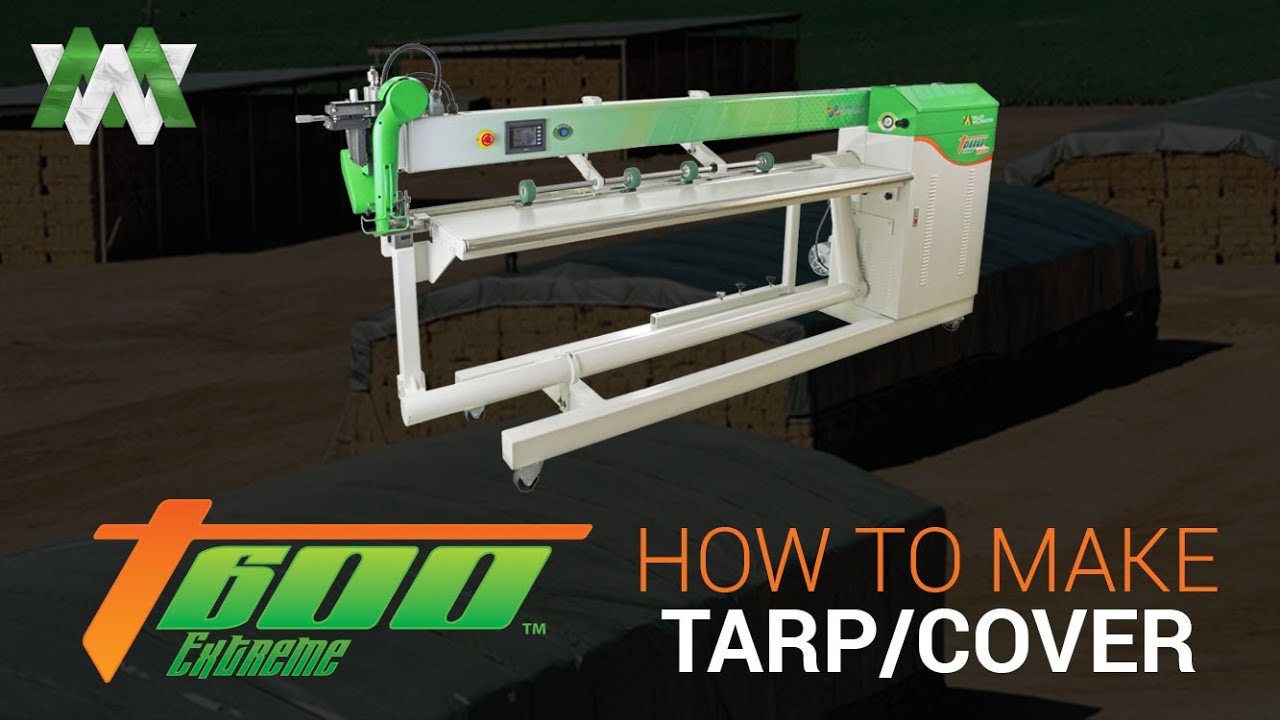

How to make a Tarp / Cover with Hot Wedge Welding

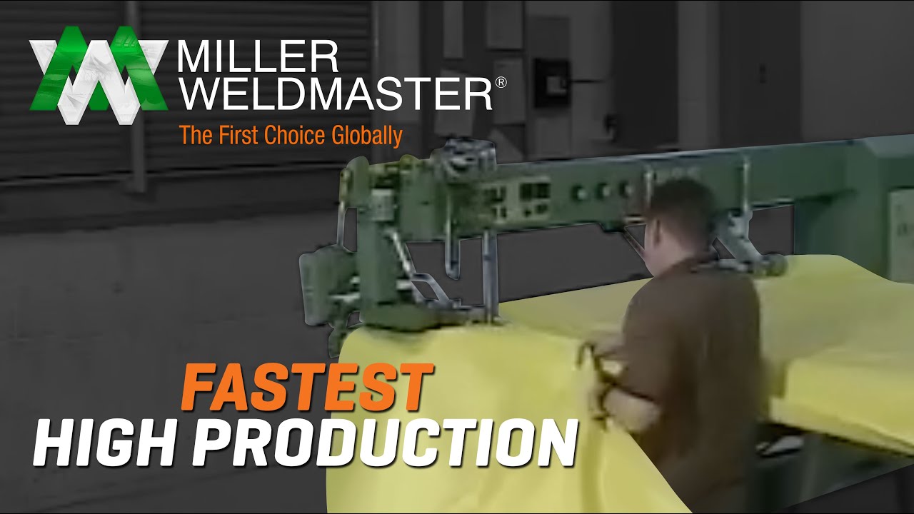

Tarpaulin Hot Air Welding Machine | High Production Welder
T600 Extreme Cover
A Tarp and Cover Producing Work Horse
Miller Weldmaster's T600 Extreme Cover will weld your panels and finish the edges of your covers and tarps. The T600 Extreme Cover will meet any production demand.
- Curtains - Truck Side
- Pergolas
- Shelters Structures
- Tarpaulins/Covers
- Quick- setting recall with touch screen and recipe storage
- Equipped for increased product versatility
- Easier fabric handling with inboard and outboard fabric puller
- Precision welding through quick, repeatable head adjustments
- Available in hot air, hot wedge or both for product versatility
- Quick, easy guide changeable for multiple seam configurations
- 208 - 240 Volts - Single Phase - 25 Amp.
- 380 - 400 Volts - Single Phase -15 Amp.
Air Requirements
- 2cfm @ 100psi
- Approx. 6kW
- Hot Air: 730˚C (1,346˚F)
- Hot Wedge: 450˚C (842˚F)
Throat Width
- 2.03m (79.9")
- Width: 0.6m (23")
- Length: 3m (120")
- Height: 1.5m (59")
- 680kg (1,500lb)
- 10 - 50mm (0.5 - 2”)**
- Up to 30m/min (100ft/min)*
* Depending on the application, the seam width and the type of material used
** Additional guides might be necessaryBROCHURES
