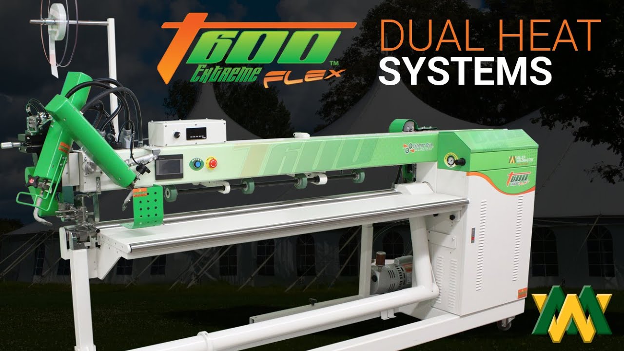

T600 Extreme Shelter
Versatile Large & Heavy Production Demands for PVC & More
Hot Air, Wedge PVC Welding Machine | Shelters, Tents, Canopies
Overlap With A Coverstrip (special 2 heat system setup)
Make Any Size, Tent or Shelter
Heavy duty construction for your largest shelter production needs. Weld large panels and finish edges on one machine. The T600 Extreme Shelter is ready for any tent or shelter application.

- Touch screen operation with recipe storage for quick setting recall
- Dual arms for increased product versatility
- Inboard and outboard fabric puller for easier fabric handling
- Quick, repeatable head adjustments for precision welding
- Hot wedge, hot air or both for optimal product production
- Easy to use controls for any worker
- Long life cycle for decades of use
- 208 - 240 Volts - Single Phase - 25 Amp.
- 380 - 400 Volts - Single Phase -15 Amp.
Air Requirements
- 2cfm @ 100psi
- Approx. 6kW
- Hot Air: 730˚C (1,346˚F)
- Hot Wedge: 450˚C (842˚F)
Throat Width
- 2.03m (79.9")
- Width: 0.6m (23")
- Length: 3m (120")
- Height: 1.5m (59")
- 680kg (1,500lb)
- 10 - 50mm (0.5 - 2”)**
- Up to 30m/min (100ft/min)*
* Depending on the application, the seam width and the type of material used
** Additional guides might be necessary
